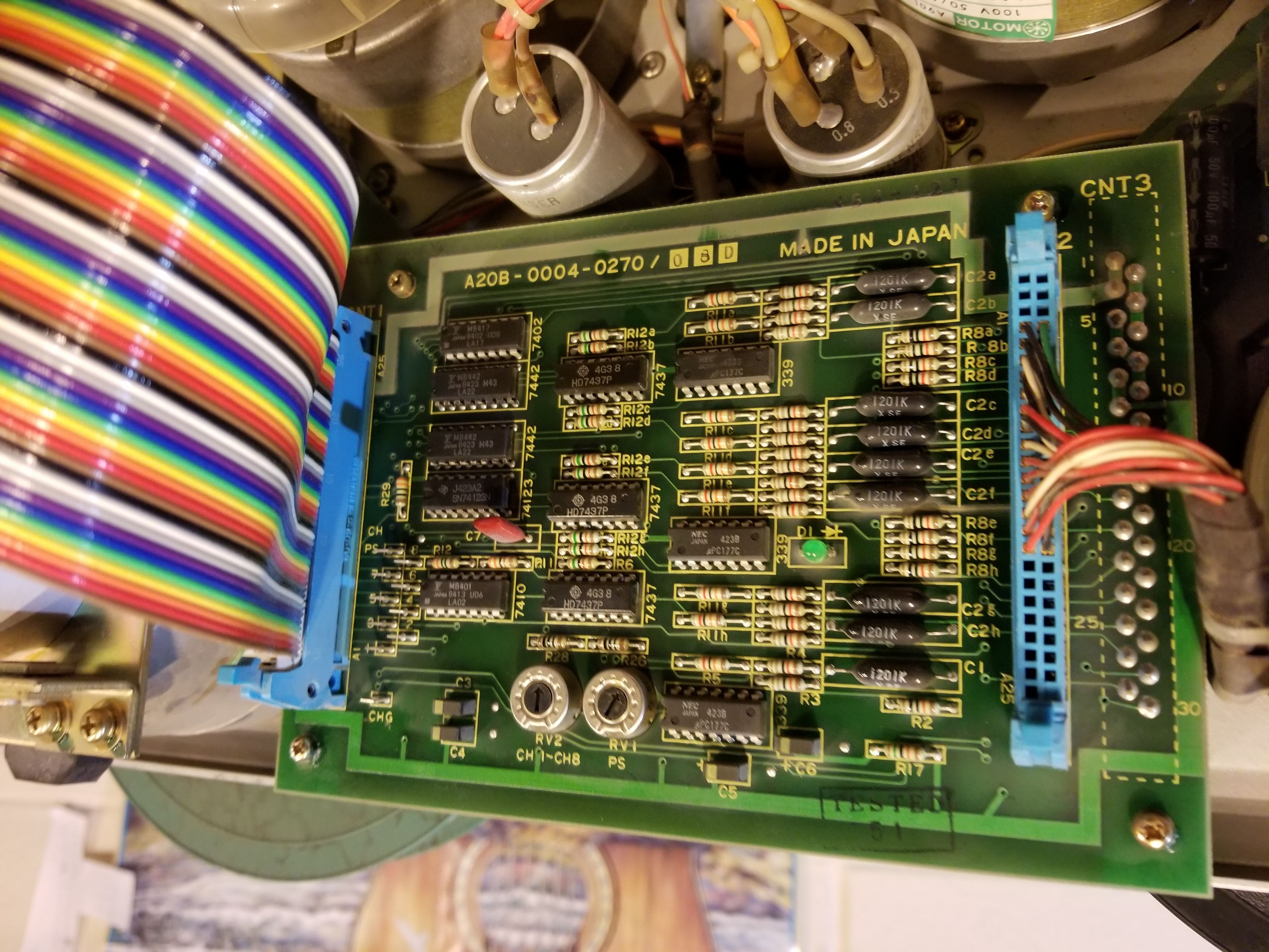

Here is the control board on the reader which has 50-pin tape in and punch
out ports:
http://vintagecomputer.net/FANUC/FANUC%20A20B-0004_IO-board.jpg
http://vintagecomputer.net/FANUC/DOSTEK-440a-BTR.jpg
The 50pin rainbow cable coming off the punch port is connected to a behind
the tape reader (or "BTR").
The BTR converts the signals and sends them to a computer's serial port so
they can be captured into a tape image.  This is what they made when
indudstrial processes converted from using actual tape readers and tapes to
saved tape images.  The BTR was the gateway between the reader and a
computer.
